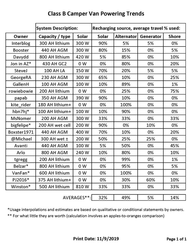

So how'd I do? Are you satisfied with the estimates that apply to your van?
There's some TL;DR in this thread that I had to skim in order to make a stab at deducing the rough usages.

32% solar, I think this number will continue to go up.

Interblog: Thanks!
