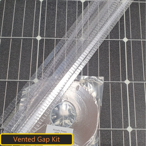

I want the VHB tape with ETFE faced panels on the Roadtrek's curved roof. I wanted something that fit the form of the roof and didn't overhang and I found the exact size that covered the central portion of the roof. To space I used this multiwall roof panel cut into strips and placed so air will move through them from front to back. I used five on each panel that faced east-west and nine on the panel in front of the fan that faces north-south. The multiwall idea was originally from solar4rvs.com.au, a picture of the spacers is here:
I used double the width shown for the leading edge of the N/S front panel and in between each of the three E/W rear panels, this allowed for two pieces of VHB tape in those critical areas.
I have seen a YT video of someone who used whole sheets of multiwall underneath of the panel, but this idea looked like it would allow more air with crosswinds.
They are still holding strong, which is better than my solution to hold down the wires, the eternabond tape doesn't have enough shear and pull strength by itself, I ended up using the VHB tape under and then eternabond.
Having done this I would recommend staying with a name brand flexible panel, I'm only getting about 25% of the rated power from these panels, even on cold days. I bought the panels purely because they fit, most are too long to fit east-west to maximize the somewhat flat section of roof space.
Next van is going to be a Transit self-build and I plan on using framed panels, I've had much better luck with them, the ones on my old class A produced over 50% in similar conditions.
