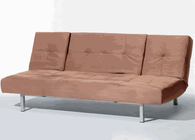

I might install this unit in place of my jackknife sofa:
If I were making a do-it-yourself gaucho bed then I would certainly consider a futon mattress.
